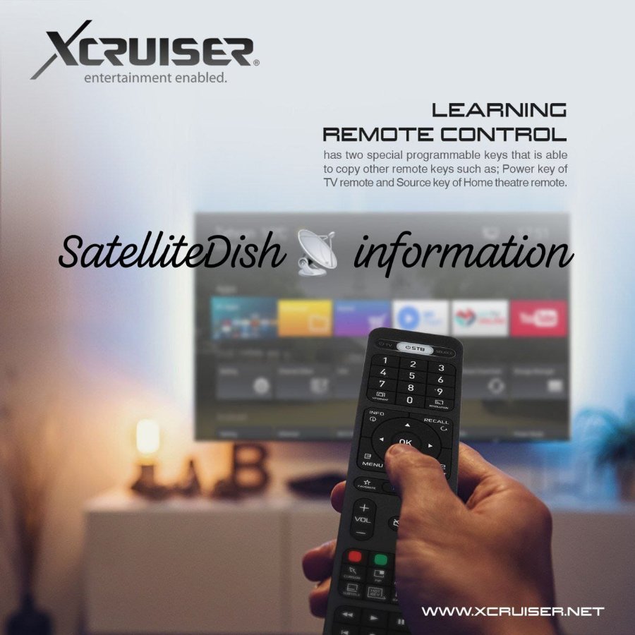

How to program the TV and Source buttons on RCU Learning remote controls
Application
Using this feature, you can turn your TV on or off or change its source using the Xcruzor remote control without the need for a TV remote control.
TV button program
1. First, hold down the TV button for 5 seconds until the STB button light changes from flashing to steady and is ready to program.
2. In this situation, press the TV button on the Xcruiser remote control once until you see the flashing mode again.
3. Point the TV remote at the Xcruiser remote and press the power button several times.
4. The STB button blinking 3 times means that the steps have been completed correctly.
Finally, press the OK button.
Source button program
To program the Source button, follow all the steps above. Only in step two, press the Source button instead of the TV button, and in step three, press the TV's Source button several times instead of the TV's power button.
