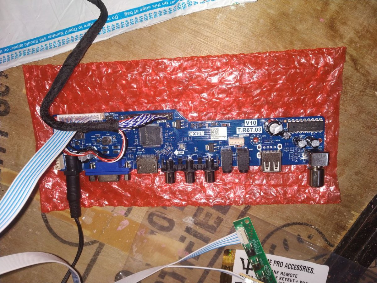

I have purchased motherboard T.R67.03 AND LVDS CABLE (40 PIN) FOR MY LAPTOP SCREEN 15.6 INCH (N156B6). I have given 12 V 2 Amp power supply.
My problem:
1. At first when I connected the board, screen and power supply, Screen burn Issue appeared (Red, blue green, etc colors).
2. After setting the resolution with the keys (Source+31181) for the resolution 1366X768 the screen stopped showing colors but flickering too much. I knew it was the bit problem, but i am unable to see the navigating options, and due to wrong keys again Screen burn option was turned on, now from that situation almost 10 times i changed resolution and restarted the board but the problem was not solved.
3. Now i googled it and found something like board firmware, I thought that flashing default firmware resets the board and comes back to original state. I searched and got this website. I downloaded the firmware in the folder it was named as V10, but inside the folder there are zip files of multiple resolutions of V7 version. Even then i followed the procedure and flashed the firmware, after flashing when the board was in standby mode, I tried to turn on the board with remote, but remote is not working.
Present situation: I searched the internet and found a T.R67.03 V10 file, I downloaded it and tried to flash it, but it was not working. Please tell me What to do.
Any help will be appreciated...

upload board picture please

Hello..
I have attached the board photo
Board picture
Board picture

I USED YOUR Software DISPLAY CAME BUT SERVICE MANU NOT OPEN I USED ''INPUT208'' BUT MANU NOT OPEN HOW TO OPEN THAT

BNdutta wrote: 28 Dec 2024, 17:18 Hello..
used 40 pin 1ch 6 bit LVDS CABIL MAYBE SOLVED THIS PROBLEM

adi11 wrote: 29 Dec 2024, 00:14 I USED YOUR Software DISPLAY CAME BUT SERVICE MANU NOT OPEN I USED ''INPUT208'' BUT MANU NOT OPEN HOW TO OPEN THAT
menu+1147
