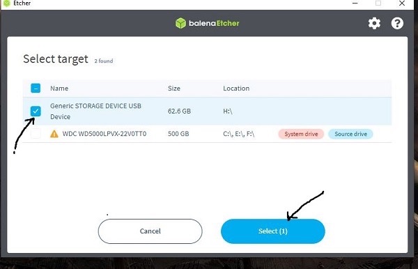

balenaEtcher program to burn bootloader file to sd card
*Putty program to pass the bootloader to the receiver
Second: the process
1:Transfer bootloader file to sd card using computer
https://www.mediafire.com/file/9d7lb8to ... r.rar/file
Download the sdcard.bin file and then burn it to the sd card with the balenaEtcher program.
Note if the program does not accept the choice of the memory card placed in the holder
... we will change the holder to another whose shape resembles a flash disk
And we put the memory card on it...... and when the burning is complete, we return it to the first holder to put it in the receiver
